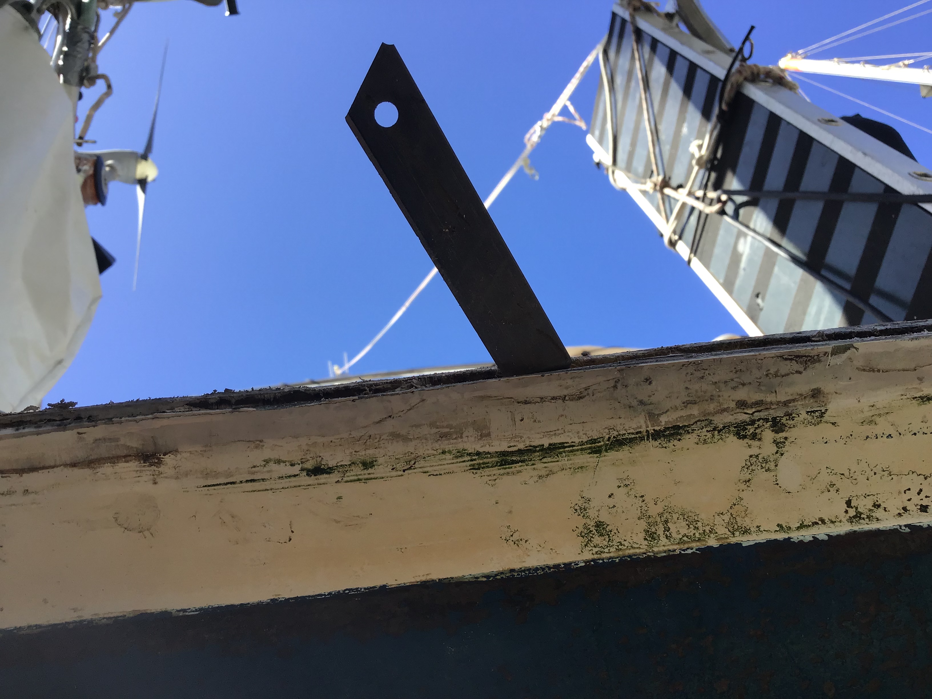

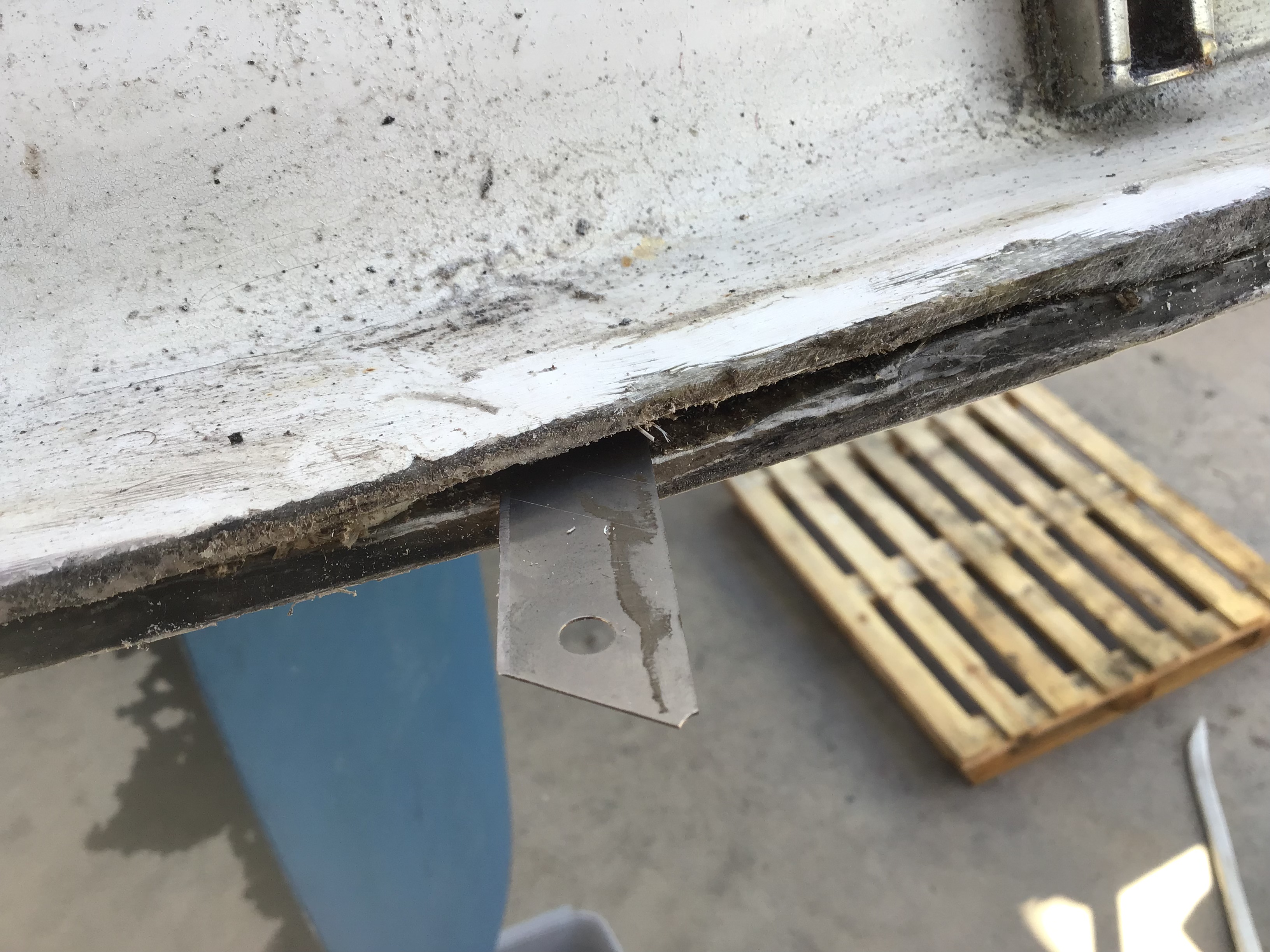

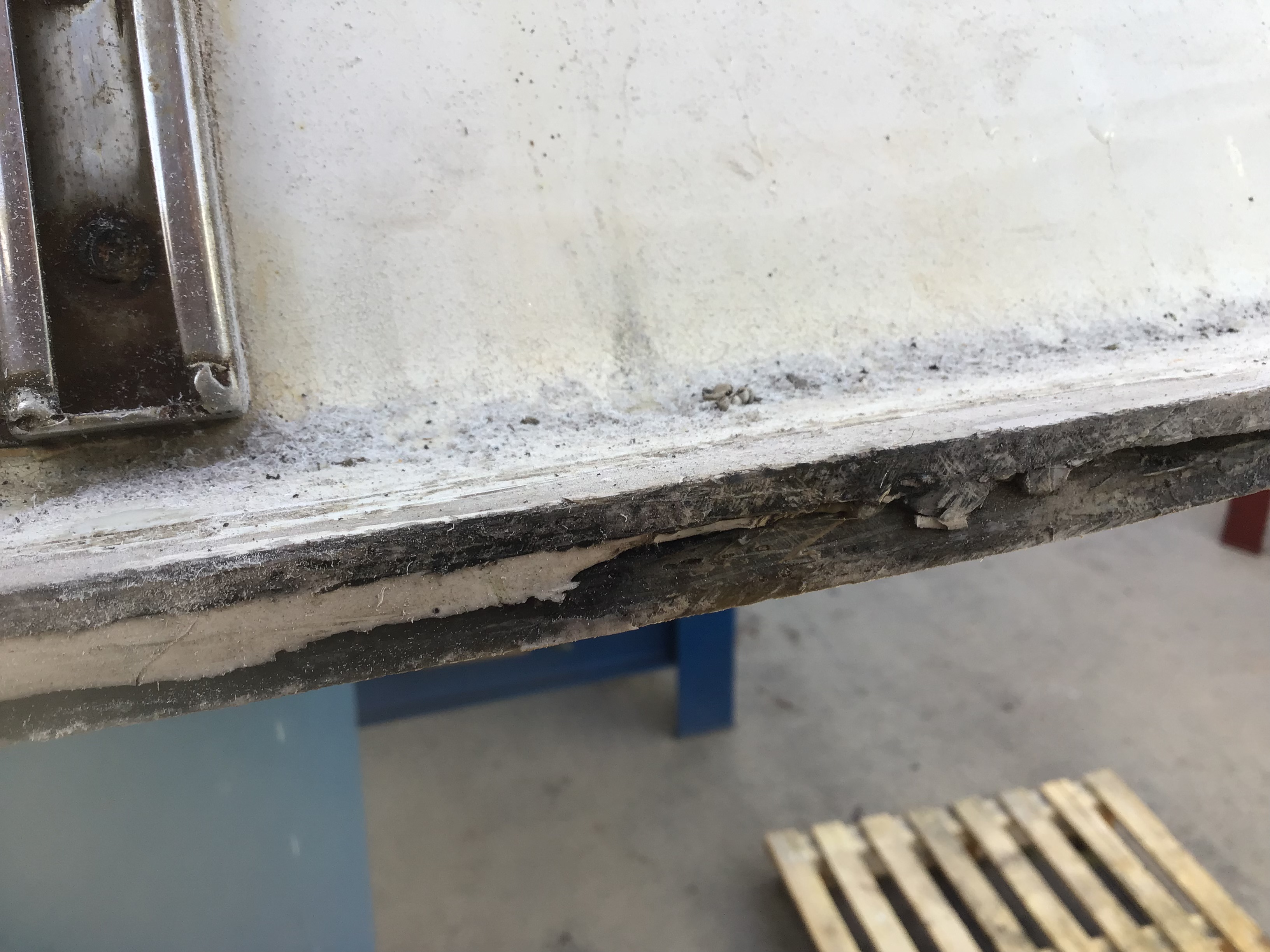

An older topic but at last an explanation for the reason of the water in the post rudder area . I always thought it was the emergency tiller's cap that was leaking , now I know better . Time after time I mopped up that space by lowering a mop through the tiller's opening getting the quadrant completely wet with saltwater whilst pulling it up to squeeze the mop dry in a bucket . Repeating the process over and over again until on average 5 to 10 liter of water got evacuated . That means this stern location is/was salty wet , humid/damp continuously .No need to point out corrosion ruled in there . Something was definitely wrong , especially with no rain for months , and my conductivity tester showed it wasn't fresh water. But alright , 2 weeks ago the boat got on the hard for winter storage on one of the Canary islands and I was able to get the transom rub rail off . And look what I found . I used the blade of a break away knife to illustrate the problem. My intention is to clean the joint thoroughly and fill up the gaps with epoxy putty , then cover everything to above the waterline with thin fiberglass mat & epoxy to firmly seal the joint . I may even use screws to also reinforce the joint before fiber glassing . Then glue the rub rail back on with sikaflex . And also tell the admiral to not step on the rub rail anymore whilst getting in or out of the dinghy . In my view the best way to detach the rub rail from the joint . But in my other project ( emergency rudder & propulsion ) , finished , tested and approved if I say so myself) , I've added an extra feature so she doesn't have to use the rub rail anymore as a stepping stone .Will soon post or send pics to Malcolm for the H&T section . www.23hq.com/sailbleu/photo/60433441/originalwww.23hq.com/sailbleu/photo/60433467/originalwww.23hq.com/sailbleu/photo/60433473/originalwww.23hq.com/sailbleu/photo/60433478/originalRegards

Good to find that one at last, Sailbleu. But a tricky one to repair with those sharp corners. At least that rub rail will cover the cosmetic issues so you will be able to concentrate on a sound repair.
Looking forward to seeing the hints and tips. You will be sleeping better already.
Post by sailbleu on Sept 27, 2019 7:52:34 GMT
Yes Rene , that's on the to do list for next year . I'm sure many boaters with a similar transom setup suffer from this weak design , perhaps even without them knowing it . But then maybe they don't carry as much weight as we do . And once the water is in , it stays in because of the hull's shape .
