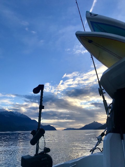

The downriggers are now mounted on my boat as per Cap'n Ron's method, which I highly recommend to everybody else. The only thing that was needed was to shave just a thin layer off the side plate that connects the mounting plate to the mounting platform. Then it fit perfectly. They guy helping me figured that enhancement and it's pretty good!

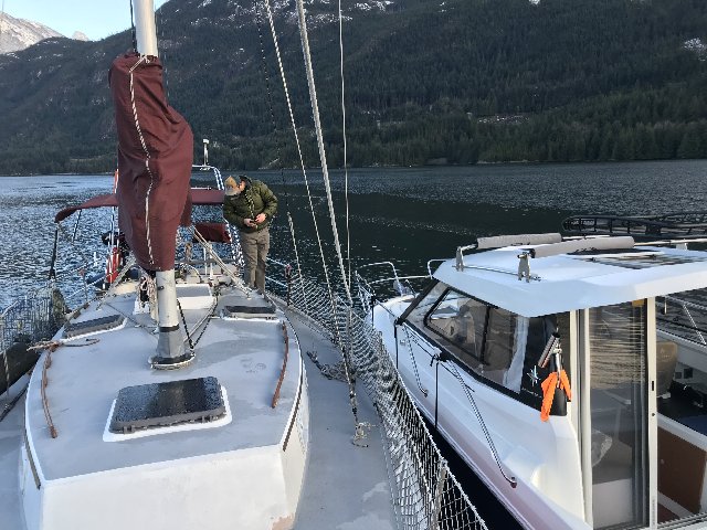

Hello All, I purchased a used MF 755 in British Columbia in late 2017, the boat is from 2014, dark blue, with a Yamaha F200. We have spent the last 1.5 years upgrading her while using the boat throughout the Howe Sound.
The upgrades that have been completed are:
1. Roof rack with roof mounted standup paddleboard holders. 2. Clarion GR10BT sound system which provides amazing sound on these boats, with both interior and exterior speakers. 3. BBQ mounted on the starboard side hand rail. 4. Rod holders mounted on the upper hand rails by the sliding door. 5. LED interior strip light mounted around the cabin windshield, front, starboard, and port. 6. Roof mounted thule basket for traps. 7. Replaced cabin table with homemade hardwood table. 8. Added downrigger mount to starboard side, similar mounting to Captain Ron!
The upgrades that I would love some input on, which I would like to complete this winter are: A. Has anyone installed an awning, either retractable or fixed, at the back of the boat. This is a much needed addition. Any information would be greatly appreciated on how you mounted it. I am considering building a retractable awning or an awning that can mount to some tubing that is adjustable in the two stern rod holders.
B. We would like to install a diesel air heater (Webasto, Planar or Espar) and I'm looking to find the best type and location to install one. Any good/bad experiences would be appreciated.
The boat has been great, despite a few annoying issues. The main issues that I have learned from along the way are: 1. Don't trust the setup of the fuel gauge, mine read and currently reads about 50% when the boat is nearly out of gas. 2. The factory battery switches that came on the 755 can sporadically fail to disconnect the 12V circuit. This is discussed elsewhere in this forum however it stems from a nut that loosens within the red handle on each disconnect switch. Make sure that these are tightened and always turned clockwise. 3. The fuel tank vent line was tied out of the way with two large zip ties from the factory. This year, the zip ties caused a kink in the vent, making for an annoying week of troubleshooting. Although only sightly kinked, the vent line caused the engine to bog down above 2000rpm. 4. I am still tracing through a few minor leaks in the boat. Most seem to be caused by caulking that is wearing on the stainless screws, or just screws that are loosening over time. As your 795's age, keep in mind that all screws need tightening and re-caulking. Also, the factory rod holders have bottom covers that are caulked in place and will fall off. I currently have a very tiny leak at the front of the hull, right under anchor chain box. If any of you have dealt with similar leaks, it would be great to develop a group to troubleshoot them. The main fun part about this boat is that they are so compartmentalized that areas are fun to access. I have been cutting access holes in the wooden hull panels as required. I'll post some pictures as I figure out how! www.23hq.com/JNorris/photo/50316845/originalwww.23hq.com/JNorris/photo/50316632/originalwww.23hq.com/JNorris/photo/50316649/originalwww.23hq.com/JNorris/photo/50316718/original

Great photos jnorris thanks for posting
