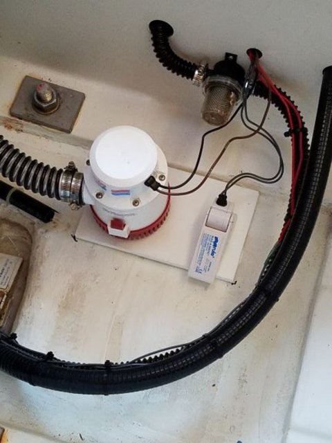

Post by sailingabe41ds on Jan 1, 2021 18:13:04 GMT
I bought a Rule 3700 with a switch and ran a hose to the starboard side at least 18 inches above the water line. I tried tapping into the sink thru hull....well the sink filled up with water. I keep it separate and independent ...its own electrical line and its own hose with thru hull without T, without one way valve,...and above the waterline. Yes, you can test it. Just get a water hose and start filling up the bilge with water. I tapped the electrical to one of the hot wires that fed one of the electrical panels. There is a fuse both at the Rule on and off switch and on one of the wires that feeds the pump. Originally I had it wired to the panel that control the lights...bilge only on when inside light switch was on....my mistake and that is what is shown in the pic. Abe
Post by sailingabe41ds on Jan 1, 2021 18:16:11 GMT
...more pics. I keep the hose as short as possible and I would not T to anything and avoid going below the water line. Keep it simple. Keep in mind these pumps are not all that strong....avoid long lines and avoid having it pushing water out of the way (like attaching to a thru hull below the water line). The pump sits on a plastic type 1/2 inch thick board that I attached to the hull using 3M 4200. There is no way anyone should feel safe with one little pump and tiny hose that runs from the bilge to the stern. Hope this is helpful... good luck. Abe
