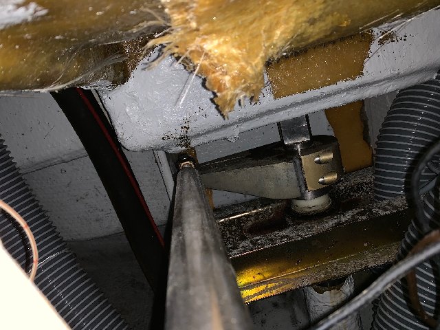

Post by johannes on Aug 12, 2019 13:06:26 GMT
I am planning to install a Raymarine autopilot for next season. Does anyone with a SO37 have pictures of the installation? That would be helpful.

Post by johannes on Sept 3, 2019 12:33:19 GMT
Ian, I can see how the linear drive should be installed. But where is the angular sensor mounted in your SO 37?
Post by panoramix on Sept 10, 2019 17:20:08 GMT
The angular sensor sits in the aft locker above the quadrant.
My linear drive was factory installed and is mounted with 4 bolts thru the rear cabin wall (starboard). The bolts are visible next to the shore power breaker in the aft locker. The linear drive is connected to the quadrant thru a hole in the rear upper corner of the starboard cabin. You will have to cut the hole yourself. The whole lot sits against the ceiling and is nicely covered with panels and lining. In the middle of the quadrant is a special mounting hole for the linear drive to bolt on. Set your rudder and drive in the middle position when measuring the 4 mounting bolts.
Post by johannes on Sept 12, 2019 18:29:45 GMT
Thanks, that's very helpful. I have an Eberspächer mounted in the aft locker, so I probably have to remove that to bolt the linear drive on the other side of the wall, but it should be doable.
Post by panoramix on Sept 13, 2019 9:25:16 GMT
Here is a picture of how it looks like in the aft cabin. The picture is from another boat, but is similar to a SO37. The L shaped cover is attached to the wooden planks. The electric goes thru the small hole in the middle of the 4 bolts. www.panoramixopzee.nl/pictures/FullSizeRender.jpeg
