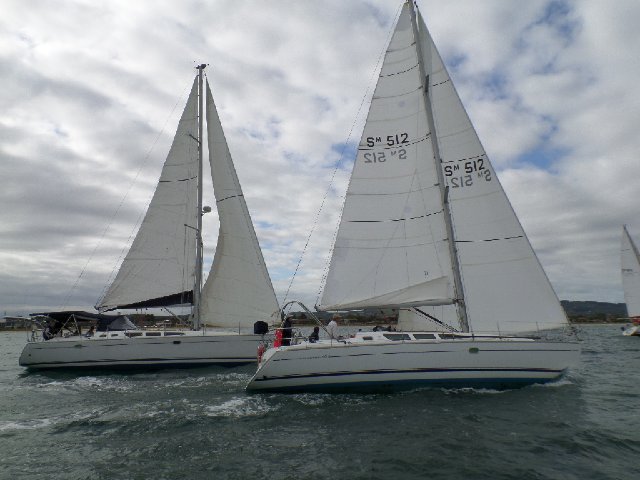

Post by gowell101 on Apr 26, 2015 7:44:36 GMT
Go for the fully battened. I bought new sails last year...China Sail Factory through local sailmaker. SO 40.3 Fully battened, 5, with bat cars. MXL design. Moulded string. Loose foot. Love them, great shapes. Easy to hoist and flake into the bag. Went for a cunningham eye as well. Using 2nd reef Spinlock to control. Skalpel Attachment Deleted
