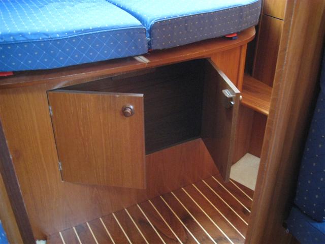

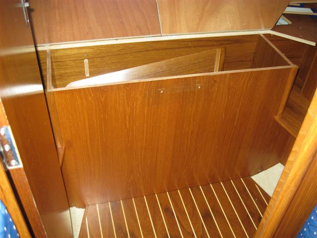

Hi All, We have an S/O 37 which has some great storage up in the forward cabin. However, to get to this extra storage space you have to lift up all the bedding which can be a real pain (esp if some one is in bed!!!). So to make things easier I added some extra doors!! It was a pretty easy and inexpensive job to do. The following pics show what and how I done it....... First pic the standard capboard unmodified:
Post by ianqv on Jan 29, 2012 22:19:39 GMT
Another pic (sorry I still have not worked out how to add numerous pics to one post)

I cut out the doors using a jigsaw (using a very fine blade).

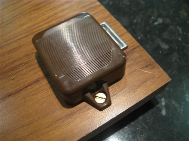

Next I fitted the latches.... easily done using a hole cutter.

Then I cut in the hinges and hung the doors...
Post by ianqv on Jan 29, 2012 22:27:12 GMT
Forgot to mention..... I fitted edging trim to the doors and cupboard surround
Post by ianqv on Jan 29, 2012 22:28:27 GMT
Hope this thread helps... Best Regards Ian
Post by sitara on Jan 30, 2012 20:11:52 GMT
Very neat job - and does provide extra space that can be quickly accessed. Congratulations! It is small things like this that add too much to the cost in the factory but can be done easily at a later stage if needed.
