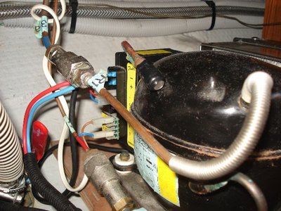

Last season I had some probs with the fridge , meaning it did not cool anymore and the compressor started and stopped immediatly after , to repeat that over and over again. When I cut the power of the unit and waited for one or two days or it was back in business when I turned on the juice. Could the prob be related to not enough gas in the unit ? Has anyone ever encountered this probleme , and how do I refill it ? Here's some pics to illustrate , I'm not sure what make it is , I guess the standard make jeanneau used for the 40 DS serie. Can somebody help me out please?

Post by sailbleu on Apr 16, 2011 2:24:30 GMT
Hi Mkremedy, I dont think overheating is the problem with my fridge , when it happened during last season the compressor was not warm at all. Like I mentioned before , after shutting it down for a day it cooled again afterwards. To go on strike again a few days later. No excessif heat , no abnormal noise , condensor free of objects. But to start the brainstorming , here's a link of frigoboat.com that is very interesting with regards to troubleshouting , refilling and more. www.frigoboat.com/home.htmlAnyway , the refusal of my unit gave me some headache during my trip last year. This cooling problem is not what you want in a mediterranean climate. Luckely I've installed a second fridge last spring , actually after the 2009 season, so I could rely on cold beer after all. Maybe I should post the procedure of the installation on this board , I've been getting alot of good comments on my local board for it. It's a 220 V AC unit stripped from a secondhand small domestic fridge. But that means translating the whole shabang , which involves some effort considering all the technical terms used. Let me give you guys a link for that , pictures tell more than a thousand (foreign) words. A dictionary would come in handy though ,also aa opportunity for practising some dutch. After all a world language dont you agree :-) :-) :-) www.zeilersforum.nl/index.php/artikelen/techniek-hoofdmenu-80/165-installeren-van-een-extra-ijskastGreetz

definitely no , i've checked the voltage several times . But what I did pick up from the frigoboat site - the troubleshouting part anyway - was that when the cooling fan's power consumption is higher than 0,7 Amps , the compressor will go into a start-stop loop. They suggest to check this by disconnecting the cooling fan and see what happens. Surely the fridge will loose capacity by lack of cooling but this brief experiment can indicate whether the fan has a malfunction.
The problem is that my fridge will work for a while , and suddenly on a unpredictable moment in time will stop working. I'm sure if I switch on the fridge now (the boat is still on the hard) it will cool for days to come not giving me a chance to work the problem. I start sailing in june , off to Norway for a few months , and as always the defect will emerge on the trip where I wont be able to try anything else than disconnecting the fan. If that is not the cause , maybe a lack of gas is .It's not obvious to refill during a trip. Refilling pre-emptive could be hazardous with regard to the compressor. It's a bit of a delemma so to speak. I was hoping if somebody out there had the same issue , solved it , and is willing to share it with us.

I am having a similar problem with my 2005 Sun Odyssey 37 -- this weekend the fridge would not cool but the compressor ran continously. I tied turning the unit off and on several times with no luck. Is there a test i can run to see what the trouble might be?

Thanks for the advice. Just to be clear, my boat has the Frigiboat unit. I am not sure how to disconnect the fan -- is the wiring easy to see and disconnect? And if I need to hook up an LED, can you tell me where the leads should be connected? I have never messed with this type of system so am at a loss as to how to perform these steps. Thanks so much!
Post by sailbleu on Apr 27, 2011 3:35:33 GMT
Mraphael, on your own picture in the back you see a vertical yellow label and the leads going into the socket next to that label. The lead corresponding with the letter F is one of the supply leads to the fan. Just pull it out and the fan stops , you can then measure the milli amps. But I'm quiet sure all will be ok. I still think there is something wrong with the amount of gas in my unit. While trying it I heard that typical hissing sound in the evaporator , and according to frigoboats troubleshooting that could be the evidence of a lack of refrigerant. I'm not sure if I can work out the led today ,.......grandchildren you see. But if you follow the link given by member rlk , you will find the way how and where to connect. Rlk's contribution - again , a very valuable one - could be a respons to my cry for help on the cruisers and sailors board a few days ago. There are by occasion a number of similar discussions going on. www.cruisersforum.com/forums/f115/bizarre-frigoboat-behaviour-54872.htmlOne thing must be clear though , our faillure has (probably) nothing to do with frigoboat , they only add the danfoss compressor and module to their system and in fact it should be danfoss who need to supply their customers with proper troubleshooting feedback ,.....if the failure is electrical related of course. Which in my case I'm not that sure of . So first things first,....the led test . I will elaborate on that in short notice. Regards

Post by sailbleu on Apr 29, 2011 4:57:20 GMT
To continue the story. [a href="  "]  [/a] This is the type of fridge I have Yesterday I managed to attach a led to the module. But to fill in the story first , I must add the fact that after my first test a few days ago - you know , where the fridge went haywire again , I cleaned up the condensor . Removed some dust with a vacuumcleaner , not excessive mind you. Anyway , once the led was connected I started the unit and had it running for an hour or so. The evaporator cooled completely , rather fast i must say. [a href="  "]  [/a] Minus 24° Celcius on the whole surface of the evaporator. There's was no led-blinking in the least and the unit kept going on as if nothing was/is wrong. Maybe I should prolong the test , which I'm about to do today. Perhaps the condensor cleaning had something to do with it , perhaps its the same story that when you perform a serious test in order to locate the malfunction , the device works flawlessly I guess it will take me some more testing to really be sure that the condensor was the culprit. But I must repeat that the hissing is very prominent , but it also does it with on and offs , indicating that sometime liquid runs in the evaporater , and sometime only gas. I'm convinced gas should not be going into the evaporator , since this can not be the principle of cooling in general is it not ?? [a href="  "]  [/a] This pic shows the possibility of adapting the compressors speed . Kolmanns website speaks about using resistants , but I suppose in my case I just have to alter the bottom pin right ?? Questions , questions and questions. Thanks for responding sofar. Regards

I guess it's time for a last update again. My unit has now had a 24 hours workingshift , and is performing outstanding. I added a small gadget so the led test became more permanent. I also installed a switch to bypass the thermostat , just in case this part starts behaving strange. [a href="  "]  [/a] [a href="  "]  [/a] I would -one more time - like to express my thanks to all who helped me (us) with this problem . A printout of the remarks/advice is now filled on board. This has been a very helpfull topic and I hope more boatowners will be guided by the info given here. Best regards
